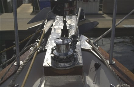

Date: Sat, 25 Jun 2005 03:17:17 -0700 (PDT)
From: alan P
Subject: Re: [pearson424] Windlass Question
it appears that there is a variety of installations out there. I am going to have to log all te pros and cons and decide what i want. Thanks for your pictures.
Here is the picture you wanted of my new windlass installation. You can see the up switch on the deck just aft of the ventilation scoop.
http://www.pearson424.org/gallery/Windlass-Installations/Wavemaker_Windlass
The down switch is forward of the scoop.
This is a powerful trouble free windlass. I have had no issues with it at all.
The chain coming out of the locker is for the second anchor which is mostly line, after a chain leader/rode. The 2nd anchor is NOT connected to the windlass except by turning the rope on the gypsy.
The chain 'round the windlass goes down a pipe in to the locker. If the chain piles up on retrieve, the windlass will lose its catch: we move the chain back in the locker with a boat hook, and then drop the anchor a foot, then retrieve again.
Two batteries are in the forward wet locker below the anchor locker. A switch/breaker is in the forward cabin. The system has an option to add a helm switch. On the whole a very excellent installation. Thanks to other members who earlier this year uploaded their drawings and photos. Kudos to Pt. Judith Marina, Wakefield, RI, for a flawless installation.
Thatcher Stone
Wavemaker
Pt. Judith, RI
Date: Thu, 7 Jul 2005 04:02:57 -0700 (PDT)
From: alan P
Subject: Re: [pearson424] Lewmar Sprint 1500 Windlass
Thanks for the picture. Did you build up the height of the windlass to lineup the chain or make room for the windlass motor?
alan
Date: Thu, 7 Jul 2005 05:51:48 -0700
From: Carter, Richard
Subject: RE: [pearson424] Lewmar Sprint 1500 Windlass
Looks like a very nice installation! Raising the winch on a platform brings in inline with the bow roller.
Rich Carter
Date: Thu, 07 Jul 2005 08:56:48 -0400
From: Thatcher Stone
As long as the anchor is turned the right way on retrieve, it just falls right over the roller and in to place. Very easy.
Thatcher A. Stone
Date: Thu, 07 Jul 2005 08:58:25 -0400
I believe that was done by Pearson in 82 at delivery to allow for the prior - Sea Wolf - Windlass.
Thatcher A. Stone
Date: Thu, 7 Jul 2005 06:13:00 -0700
I put a stainless swivel on my anchor. This allows the anchor to rotate on the roller if it is twisted. The link below is to a similar item; not exactly the same as mine but close. It is used instead of a shackel.
http://www.westmarine.com/webapp/wcs/stores/servlet/ProductDisplay?store
Id=3D10001&langId=3D-1&catalogId=3D10001&productId=3D25687
Rich Carter

I saw pictures of one windlass installation that intrigued me. I think it was Steve Sears' boat? Anyway, he had an electric windlass in the bilge, and a manual windlass on the bow. Both were on the same chain, and could be used to assist each other. The main advantage was that the chain was all stored in the bilge. That seems very advantageous to me.
