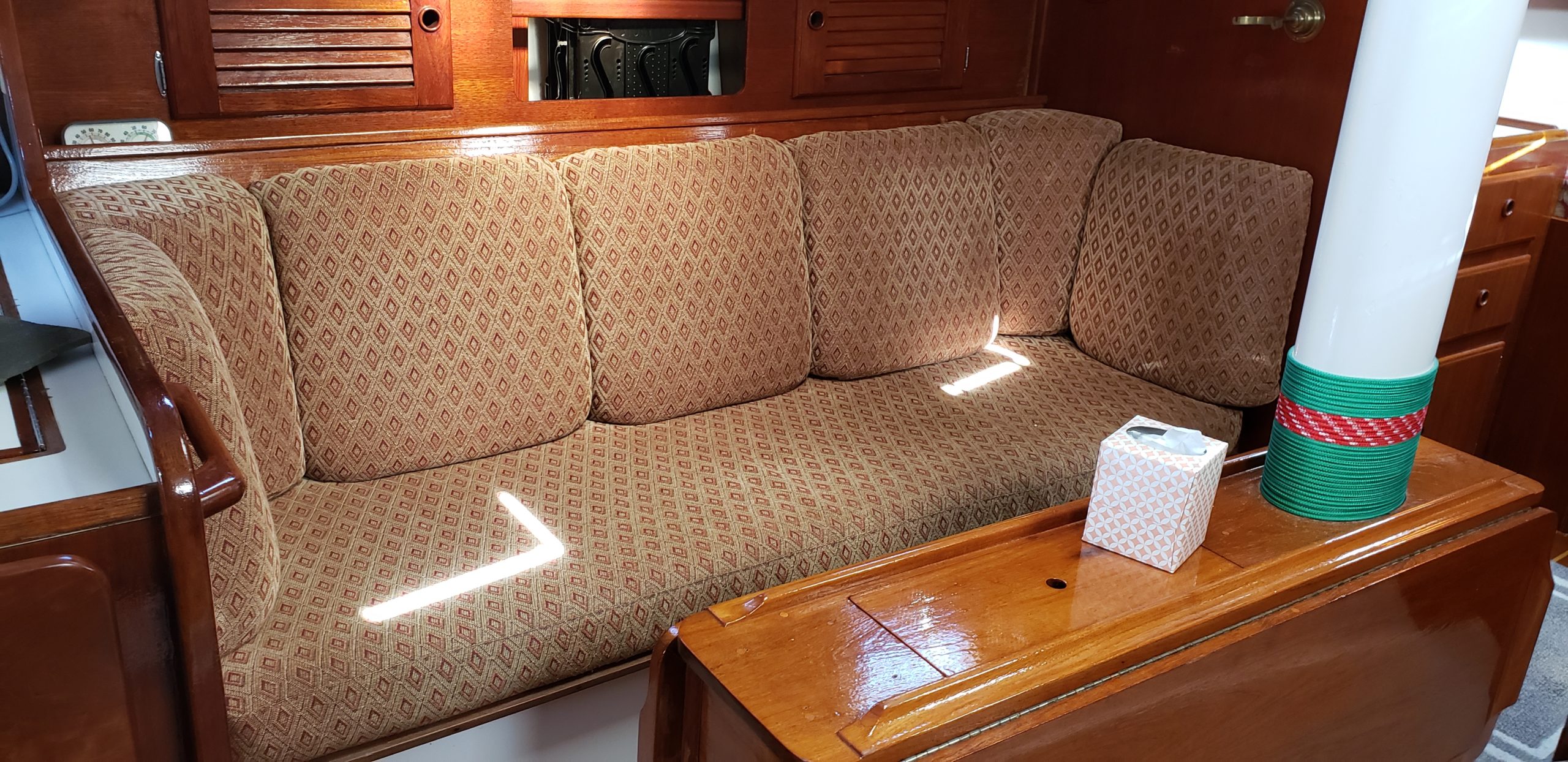

      1. Our 1978 424’s saloon cushion arrangement is a single bottom cushion and 7 back cushions that form a U on each side. Each of these 7 back cushions have a plywood back. I have attached a picture.
      2. We replaced the cushions 13 years ago when we bought the boat. We plan to update these cushions over the winter.
      3. I’m interested in hearing from other 424 owners as to different configurations of the back cushions.
      4. We are thinking about removing the 4 back cushions that make up the ends and the corners and extend the width of the 3 middle back cushions to cover the entire back.
      5. Has anyone else done this?
      a. If yes, are the 3 middle back cushions the same width or is the middle cushion the same size but the forward and aft cushions are wider?
      6. Currently each of the plywood backed cushions attach to the boat via 2 vertical strips of industrial strength Velcro on either side of the storage hole.
      7. What other ways are these cushions kept stable in the seating area? No attachment? Velcro across the top of the back? Some type of hook system?
      8. Has anyone made a separate thin, rigid but removable cover for the storage areas and made the cushions without a plywood backer?
      9. Our current bottom cushion does NOT have a knee roll. We do not use the saloon seating as a sleeping area. We are contemplating adding a knee roll during this makeover. Who else has a knee roll and do you find it functional / comfortable?
      10. Is there anything else you have learned and would like to share related to saloon cushions?

      Interesting idea. I’m not sure it would work for me because I use the forward end cushions a lot. I have a flat-screen TV mounted in on the back of a galley cabinet that is over the refrigerator. I prop myself up in the opposite end to watch TV. I suppose I could just use a throw-pillow there. As it is, if we have extra guests, the main cabin settee is too short for sleeping unless you remove the end cushions. Then where do you put them at night? It’s also a bit snug for dinner if you have more than two guests. I might give it some thought after I see your photos. Replacing my main cabin cushions, for the third-time, is on my list.
      As for the velcro attachment. That’s the way the boat was built. It never really worked for me. The cushions would always end up on the cabin sole when underway. I replaced them with snaps, attached to cloth tabs on the top of the cushions. Photos can be found here in interior mods under BlackSheep. The photo linked below is decades old but shows the snaps.
      https://www.pearson424.org/photo-gallery/wppaspec/oc1/lnen/cv0/ab32/pt183
      If you decide to continue with a velcro type attachment, consider using a more robust type. The tape used to attach EZ-Pass transponders is much better. It can be purchased online. Google for Toll Tape. You’d have to experiment with how much to apply. The stuff sticks together very well.
      I’m sure you know that you could make cupboard doors to fill the behind cushion holes. You’d probably have to square-off the hole corners but it sounds simple enough. A piano hinge across the top would work.

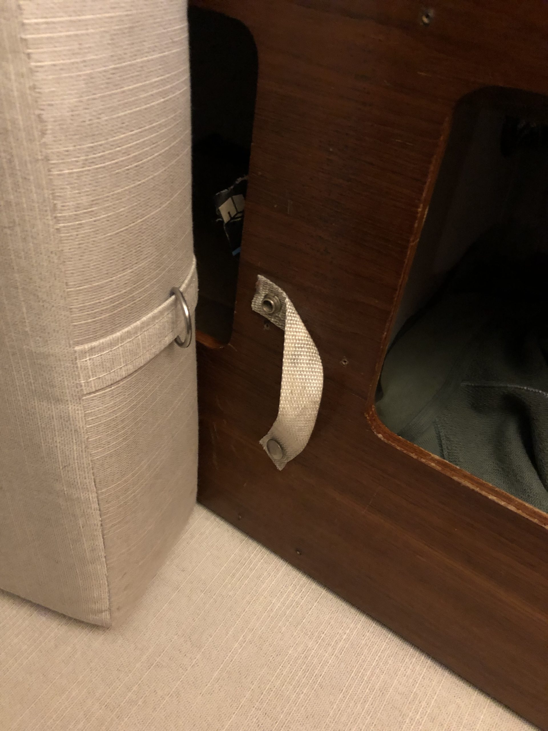

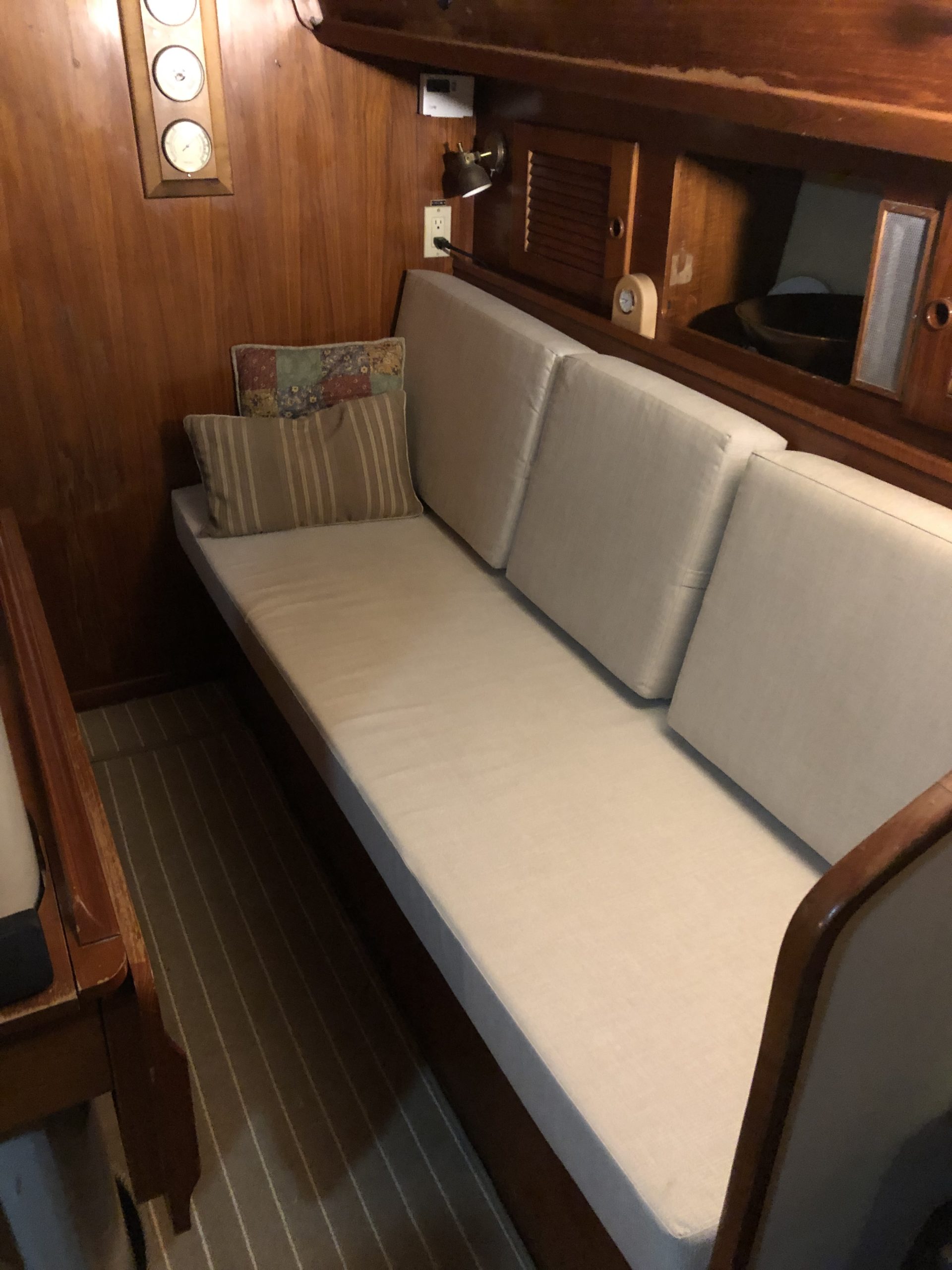

      I redid our cushions two years ago. I kept the same arrangement that the PO had made as it works well for us. We have 3 back cushions(4” foam), the middle being shorter than the two outside cushions. They have a snap/strap attachment. Each cushion has a strap & stainless D-ring sewn to each end, on the face of the cubbies there is a webbing strap with snap attached which holds the cushions in place. There is a little gap between the cushions to allow attaching them. They are double sided so they can be turned around if one gets stained! I’ve never felt the cushion sink into the opening of the cubbies.
      I did go with Sunbrella fabric. I chose the silica silver as I have done several boat interiors with this color and really like that it has some thread pattern so it’s not a homogenous color and it’s bulletproof for cleaning. Just yesterday I removed the covers, put them in a bucket with some bleach and dish detergent, agitated them for a bit, then layed them out on the dock and scrubbed with a deck brush! I don’t think there’s another fabric that will take that abuse. I took the photo’s below after the cleaning/drying and re-stuffing.
      I went with new 5” foam for the bottoms which just fit snuggly under the cubbies and the table swings by with a little effort. I considered knee rises but thought that I might not like the look & feel when done with sunbrella, I feel like that’s better accomplished with vinyl.
