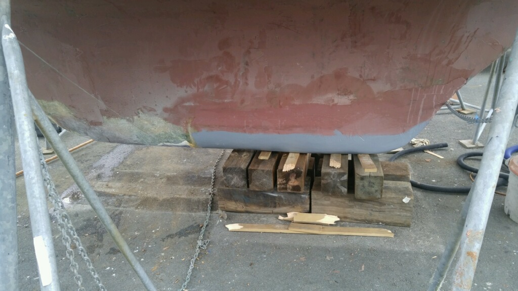

ParticipantUpdate on progress!
We’re almost there with the repair – just a few more days to finish it up. Here is the updated photo. I have it on good authority that it holds water – I’ll be fitting a recessed garboard drain plug for cleaning the boat out.

November 2, 2016 at 1:55 pm #221816
emberleybillgmail-com
ParticipantHoly Crack Batman!Bill EmberleyEdit One Productions, Inc.

ParticipantDid you run aground? Was it a PO? Was she blocked improperly? -
November 2, 2016 at 4:26 pm #221821
Site AdministratorKeymasterDan,
This was the PO’s doing, I am afraid. Its finally mostly repaired. I have a few days sanding and painting coming up soon, to leave it with a winter coat ready for a late summer splash next year.
info@pearson424.org -
November 2, 2016 at 4:37 pm #221822
ModeratorThis is not an unusual occurrence with these boats. The bottom of the keel was very thinly made and not reinforced where the molds went together. A bad blocking and you have a serious issue.I repaired mine when I first got the boat and it was fine until it blocked wrong in Florida crushing the keel. The haul out after that, my friend Cory and I put 9 layers of biaxial cloth wetted out with thickened epoxy. At this point I could block the boat there but I still don't.
If you have a 424 and your bilge is constantly wet, you may very well have this issue.
For newbies: Always block the 424 at the front 18″ or so of the keel and the very back of the keel. All the part that sounds hollow when you rap on it leave unblocked.
