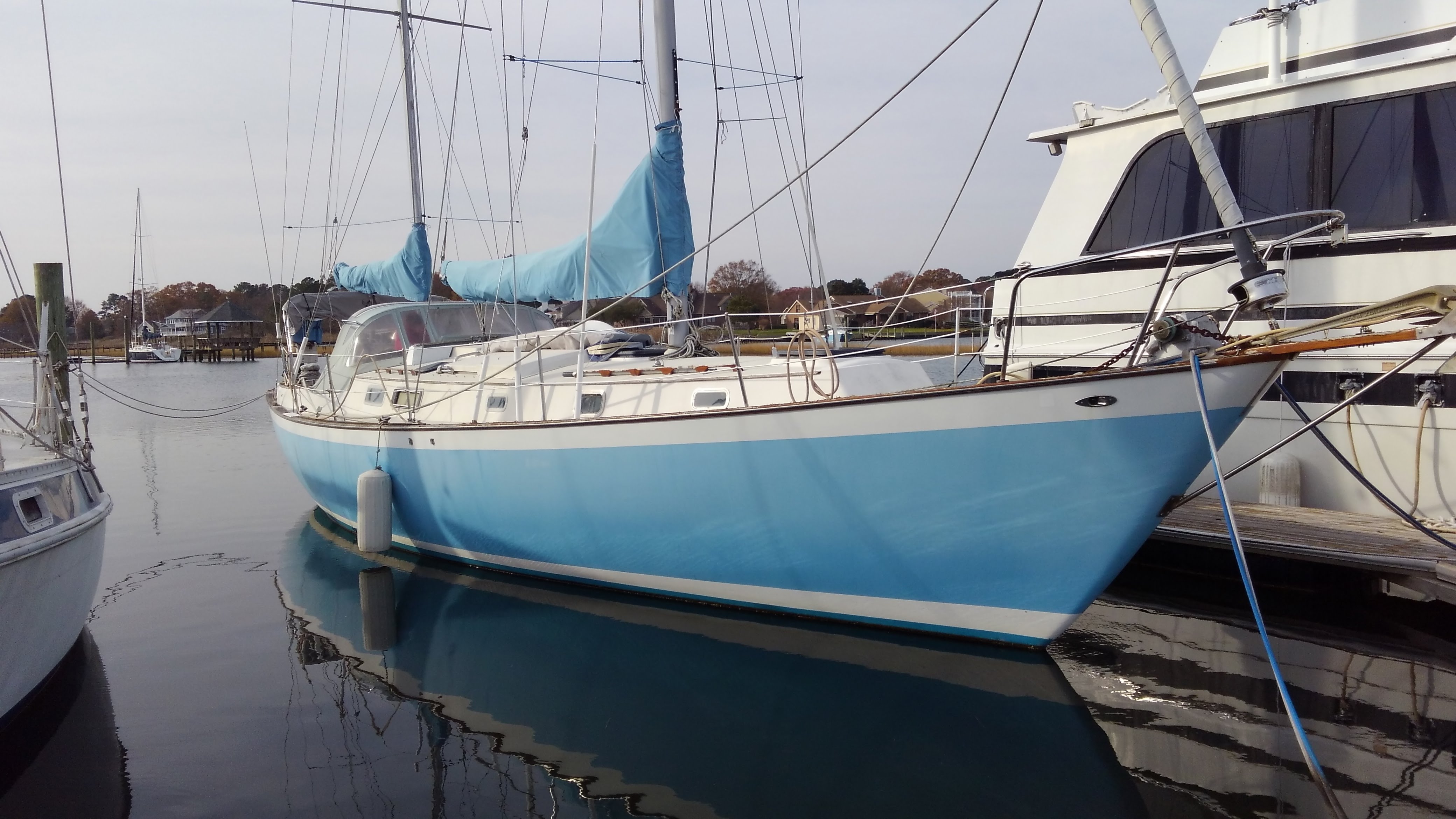

      Hi Everyone, This is Dave and Nikki. New owners of hull #7. We are renaming her BooRie and she hales out of Hampton Va. We will be pulling out the “vintage HVAC’s that are hogging up the bilge and installing a pair of new Hvacs. We are working out in CA right now and I can’t do the math to determine my required BTU’s but I’m thinking of a 10K unit for the aft berth (B layout) and a 16K for the rest of the boat. Does that sound about right?
