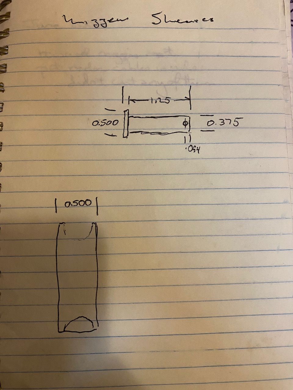

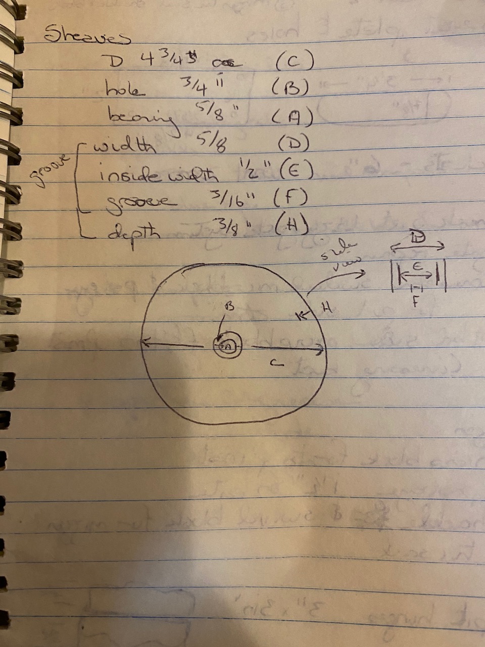

      So now that I sent that message I, of course, found the notes on the sheaves.
      4 Main sheaves –
      Diameter: 4.75”
      Axle: 5/8”
      Width: 5/8”
      We reused the existing axle as it was in good shape. Doris is a fresh water boat.
      2 Mizzen sheaves –
      Axle: 3/8”
      Width: 1/2”
      Can’t find the diameter measurement
      Attached are pictures of our notes page. These notes are from Spring 2004.

      IMG_1522
      IMG_1523
      1. sheave info - main
      2. sheave info - mizzen
    • #225735
