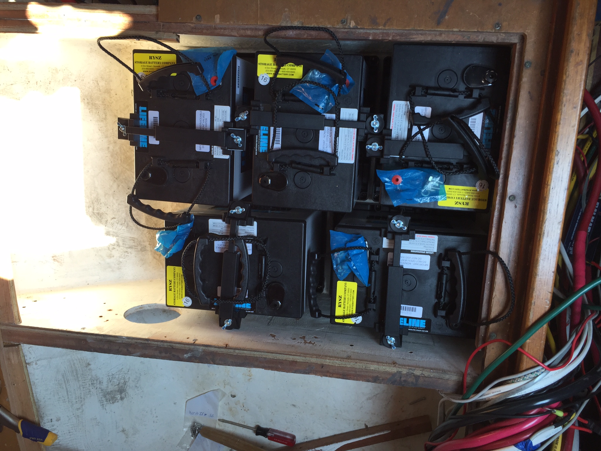

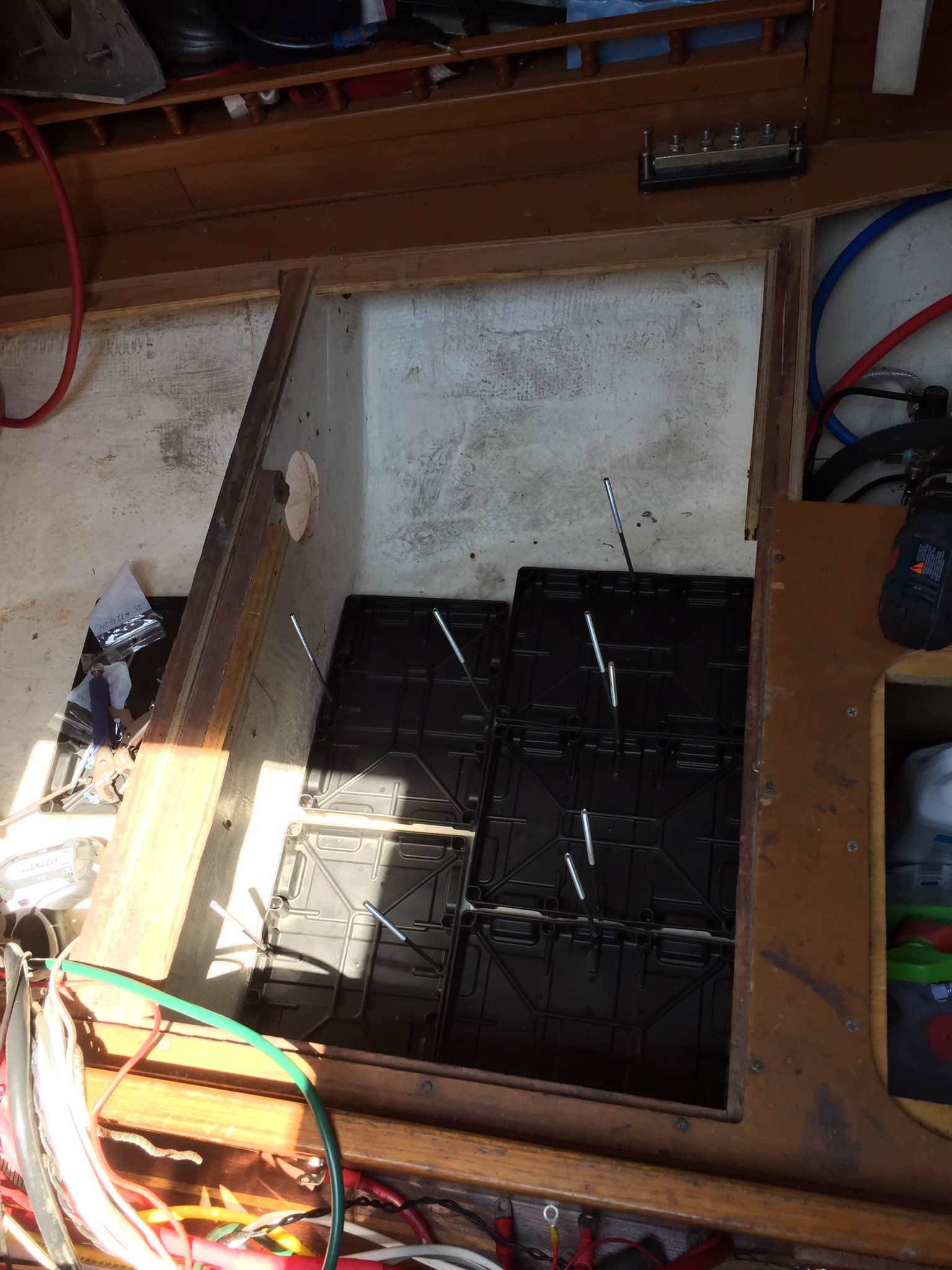

      When I bought my cutter she had 4@4D under the aft berth, two in each of the aft-most compartments. These were AGM so there was not a lot of vent consideration. However there is an approximately 4×5 vent, but this is largely to provide some circulation to the inverter, which is also under the berth. After hernia surgery, I replace the 4Ds with 6@6volt Lifeline batteries. I also have a 12v starter battery and my water heater under the berth.
      I don’t have pics of the 4Ds, but I’ll try to post how I setup the 6@6v. There are four sections under the berth, I’m using the aft two to hold batteries.

        That looks super.. I am thinking of modifying the patricians to get them in..
        Need to make sure that they are not providing any needed structural support to the hull.. Thoughts?
