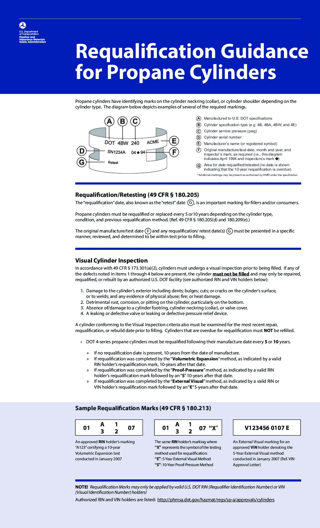

ParticipantMy propane tanks we getting a bit rusty so I thought i needed to see if they required any recertification to refill.
It turns out they do..
10 years from the date of manufacture and every 5 or 10 thereafter depending on the type of recertification that was done..
Without recertification they are not supposed to be refiled.
I have attache a pdf here that is the official page from the Transportation department..
It also shows includes the marking information required for each tank and how to read it.
Hope this answers any questions.
