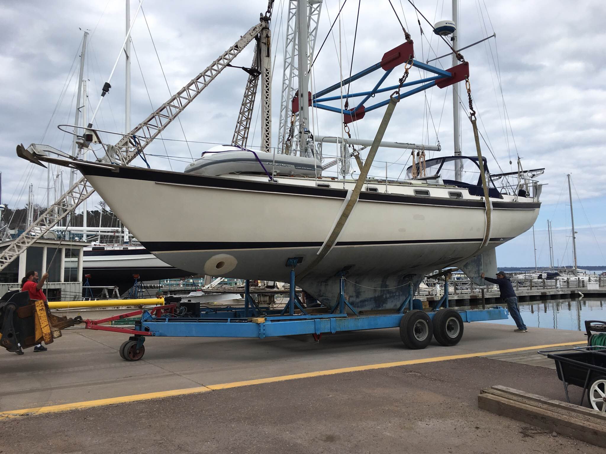

      dhjppn
      We have been pulled both with a crane and with a travel lift.  We have never needed to pull either mast. On a smaller lift we did need to remove the fore stay once.
      When we get home tonight I'll send you some links to pictures.

    • #221656
      Very interesting photo.  I’ll have it on hand…
