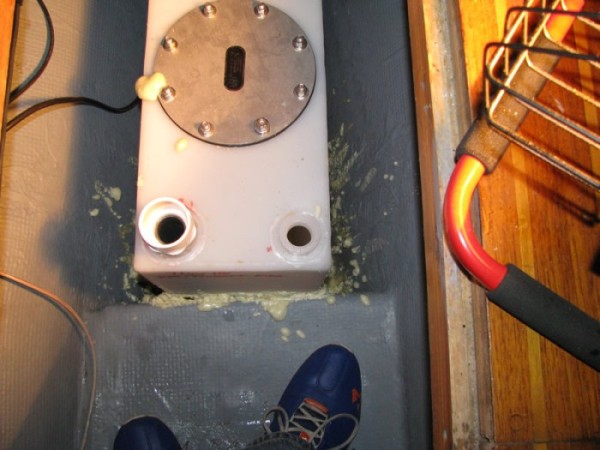

      When I bought Pelican there was no holding tank – just an ElectroSan (which I found out later was hooked up backwards negating it’s usefulness). I measured and ordered a tank to fit behind the mast in that lovely flat, wide area that exists. That would have left the deep bilge for hiding a family of Mexicans, two red Ferraris and a wide screen TV if that’s what I wanted to do.
      After climbing down there once to work on the bilge pumps (rewired recently with appropriate switches and breakers – see http://thesailinglife.blogspot.com/2008/10/i-cant-believe-summers-gone-again.html). One thing I realized was that I’m really not likely to use that space effectively – I purchased an old people’s grabby thing just to retrieve pens, screwdrivers, wrenches, cans, and whatever else I drop down there (which grows in number and variablility).
      So, putting the original tank in storage (it’s available for anyone who wants it – 12″ x 16″ x 36″ with 1-1/2″ fittings on one end – the 12 x16 side and 1″ vent fittings on a 16″ x 36″ side – $250 new, make an offer) I ordered a tank that would sit in the deep area and on the floor of the bilge. It came out to be about 30 gallons. It’s functional, but there is more plumbing to do for the macerator pump and the manual pump. When I finish it this winter, I’ll write about it. For now, here’s a picture of the top of the tank.
      Under the water tanks in the salon is a tremendous volume that’s beautifully dry, including stringers that provide a safe haven for things that are stowed outboard. True, I haven’t filled all my drawers and stuff, but I have a lot of heavy tools that need a home other than under the table. I expect to have a full hydraulic rigging press aboard when I leave.
      So there you have it. A plan of sorts.
      Bob
