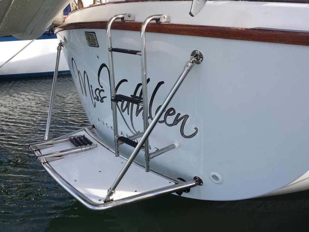

      Miss Kathleen
      Hi David
      We had the same dilemna and was solved by building two access points.
      The first was a folding ladder on the side.
      The second was a swim platform. The is also a small ladder from the platform for cockpit access. I would have made it deeper but plan to add a wind vane in the near future.
      Overall I am very pleased with the results.
      I wiĺl post some pics soon
      Regards
      Dennis

      Miss Kathleen
      Attached some pics of the new platform.
      The white base is temporary and will be replaced with a teak grid.
      The tension supports work well in “helping” the dinghy into the water.
      The small ladder works well, and is vertical.
      I did not want to go out further as a windvane is yet to be fitted.
      For the next time – a little wider, and could even be higher
      Platform is 500mm above water level
      Not sure how to add multiple pics

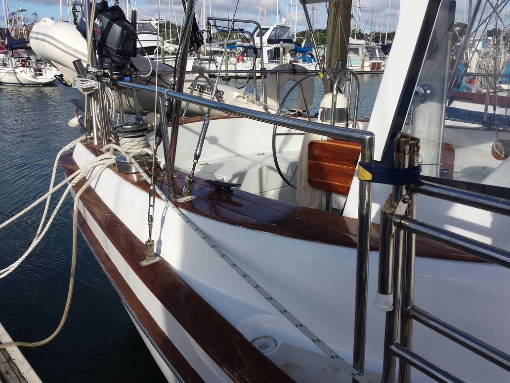

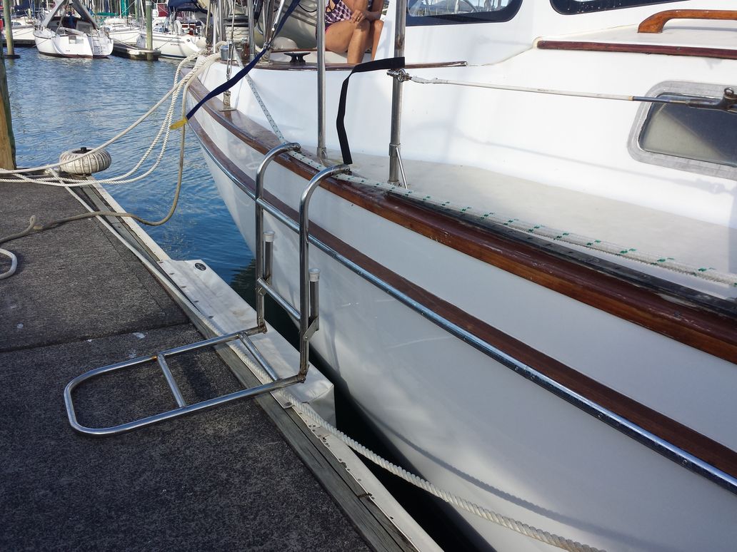

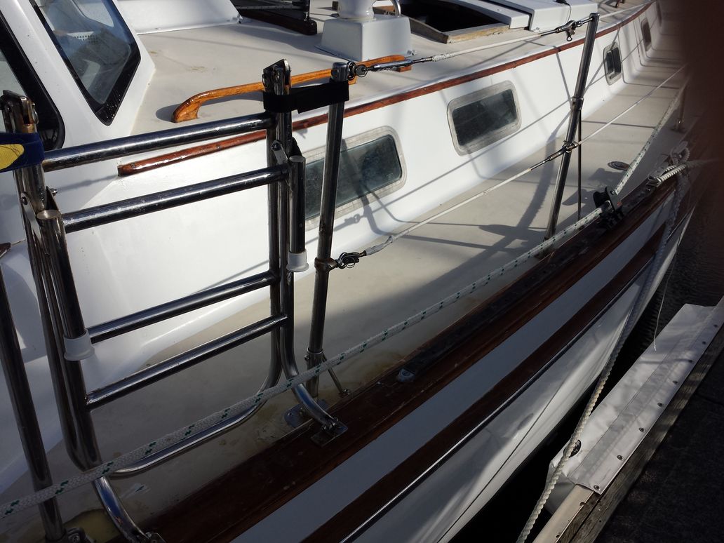

      Also added a new folding ladder which conveniently works well as a step from the jetty.
      Removed the wire safety line above the winches and replaced it with a stainless tube. This works really well especially as a handhold. This makes it much better for winching as the safety lines always snagged the top of the winch handle. This also provided better support for the folding steps. The winch wqas moved when the hard dodger was added, and is a major improvement in boat handling.
      Then, since the folding steps used up some of the space – moved the gate further forward.
      I still need to add a better method for securing the steps.
