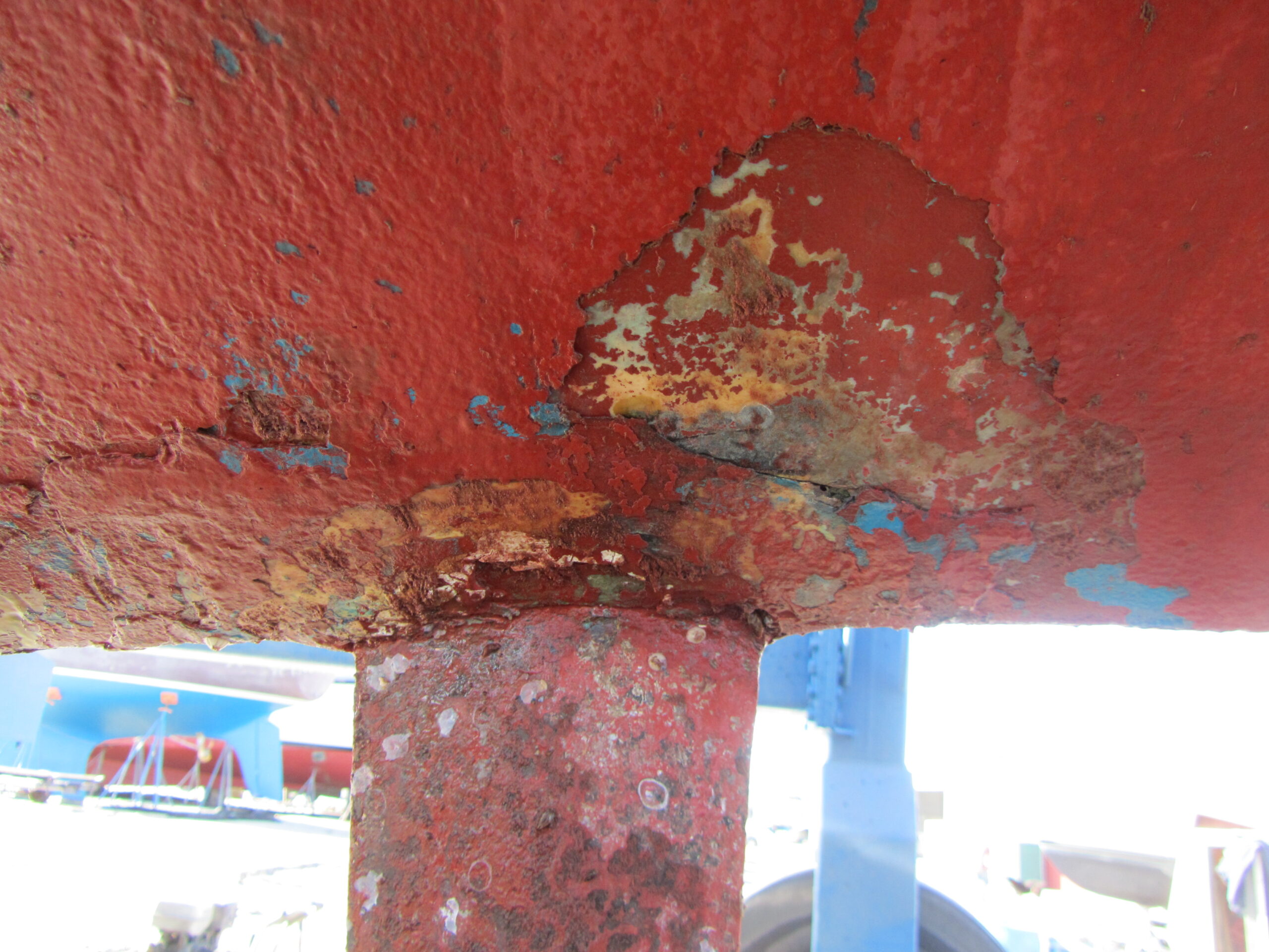

ParticipantJust thought someone would like to know how my strut is attached to the hull..
In the process of stripping the bottom paint I noticed that the fiberglass was not sealed around the strut. (See Pic 1)
