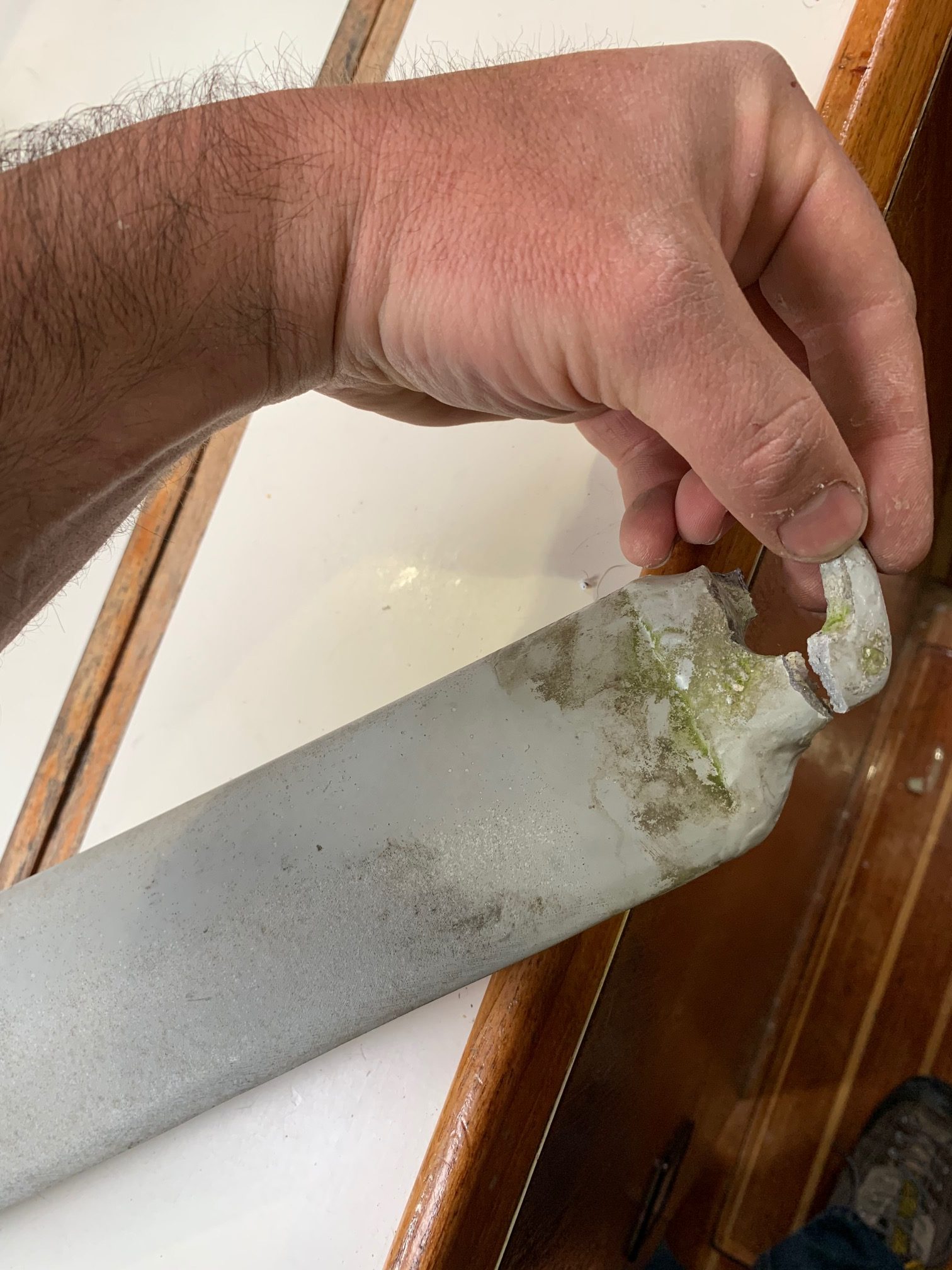

      I was wrapping up installing new standing rigging on the main mast of a ketch rig. When I tried to feed the wire into the claws at the end of the spreader, the tips snapped off. Completely corroded! Yikes!!
      Does anyone know where I can order a set of new spreaders that will fit?
      Rob

      I never liked the stock spreaders. They aren’t attached well to the mast. I had to put clamps on the shrouds to keep them from drooping. I think Metalmast made them. I talked to someone at US Spars last year about replacing them with their spreaders. I forget what he quoted but it was ridiculous, maybe a grand each.
      You could contact Metalmast about replacing or repairing what you have. Or you could bring them to a local welder and ask him if he can fix them. My guess is the latter option is less.

      I took a second look at your spreader photo. If it were me, I’d cut off the ragged end of the spreader and drill and tap to put a pair of stainless studs in there. I’d put a stainless plate across them and clamp the thing down on the shrouds with a pair of stainless nuts. You can cut the end off full-thread stainless bolts to make studs. Stainless u-bolts could donate the straps. Acorn nuts on the very end would protect your spreader boots and sails. The advantage is that when you clamp them down on the shrouds, you support the spreaders so they can’t droop.

      That’s actually a pretty good idea. I’m a little freaked out how easy the tips broke off and worried the inboard side of the spreader is compromised as well. The spreader tips looked OK visually.
      I’m hoping Rigrite’s quote isn’t too wild and that they have a quick turn-around. Otherwise I might be following your suggestion!
