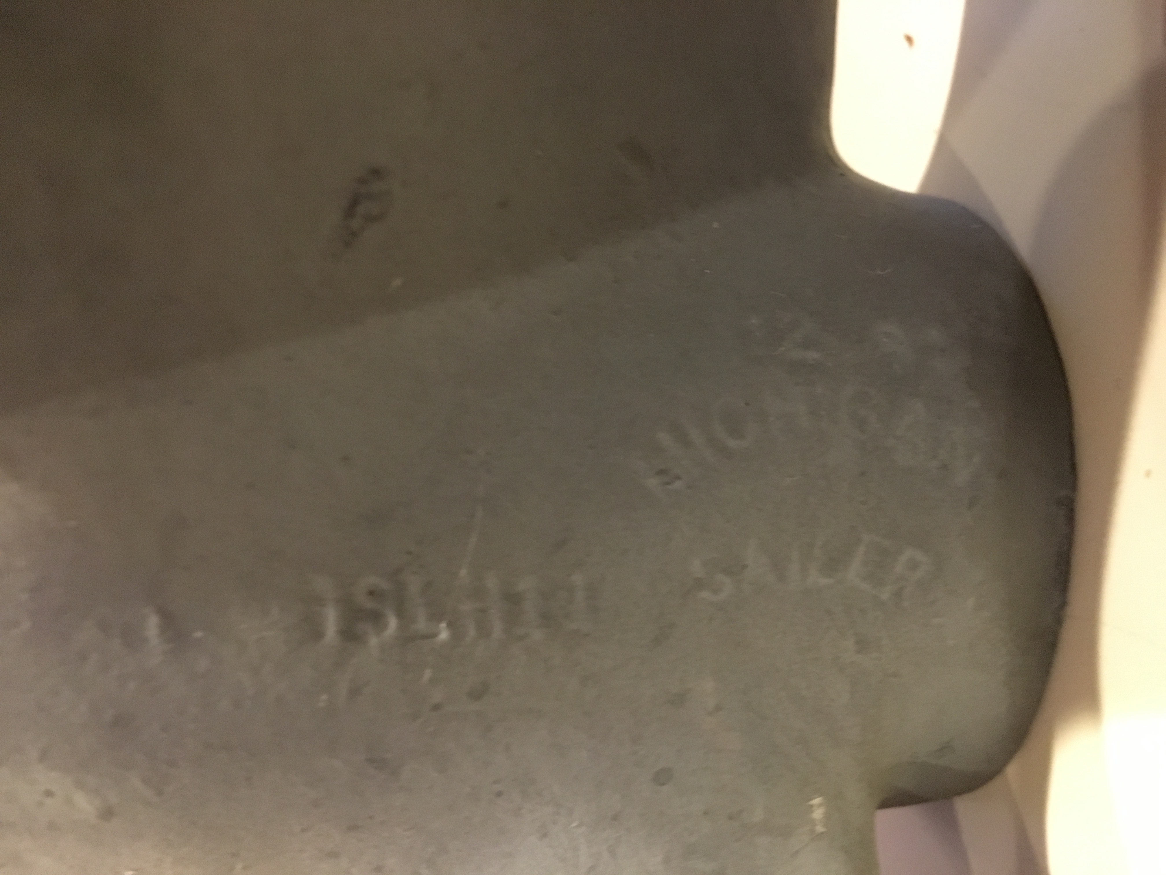

    Pic of 18LH11 mentioned above
    in reply to: Original Propeller size? #224007
    I found the prop.
    This one available for trade or sale
    Shaft 1.5”
    Diameter 18”
    It marked with
    18LH11. I’m assuming that means a 18” diameter, left hand, 11 pitch
