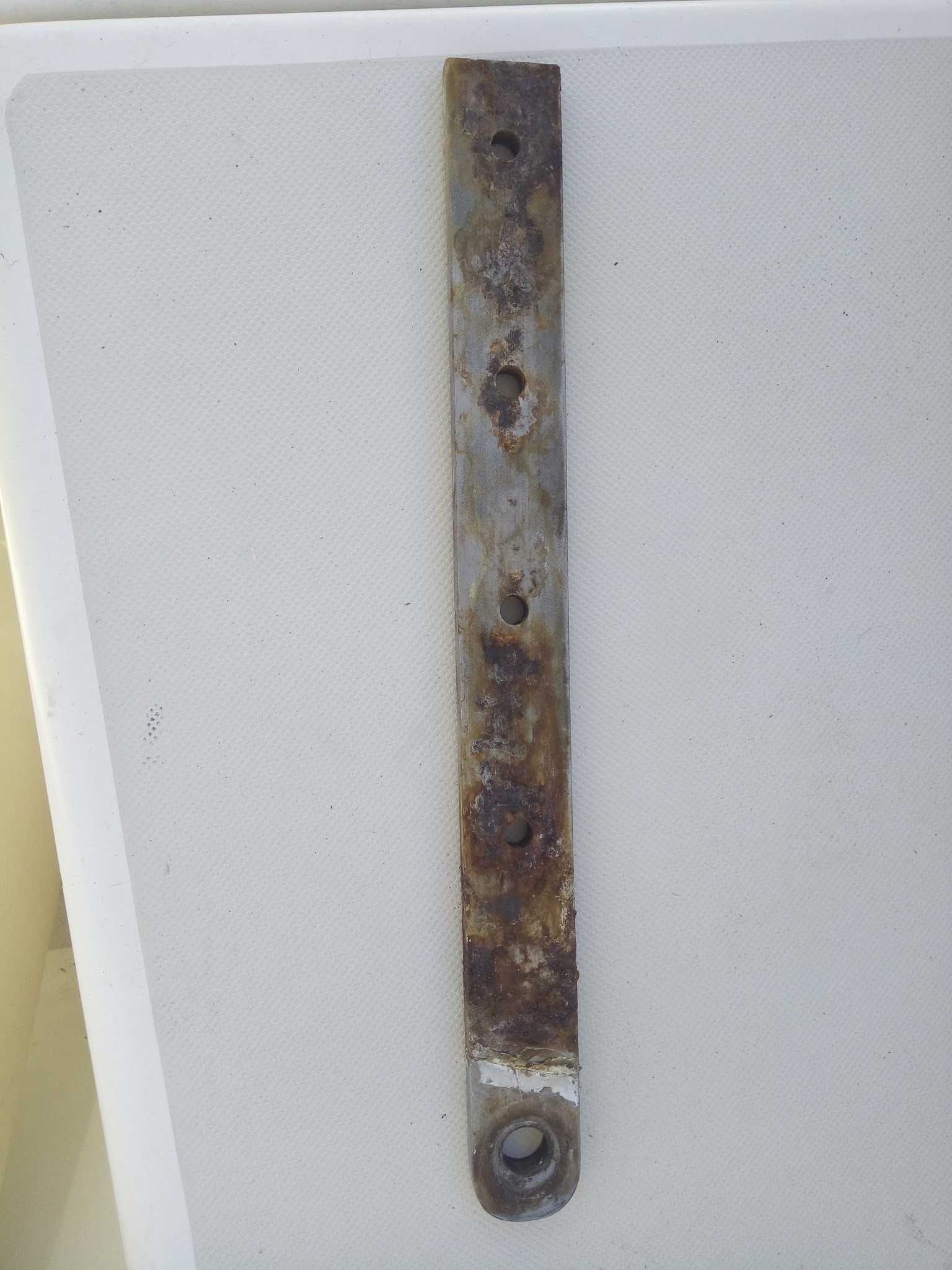

    in reply to: Lost a Chainplate during Irma #223684
    Thanks a lot, Rob! Yours do look a far sight better than mine. See the picture of my port forward.
    However, I just ordered the flat stock and hardware this afternoon and visited a great little shop that will drill and round the ends for very little money. I’m going to have them do my backstay and stem fitting as well. I should be able to get away with less than $750, all told. Thankfully, I don’t have a mizzen and my stays’l fitting is in great shape. I knew this job was coming…
    1. Port Forward Lower Chainplate
