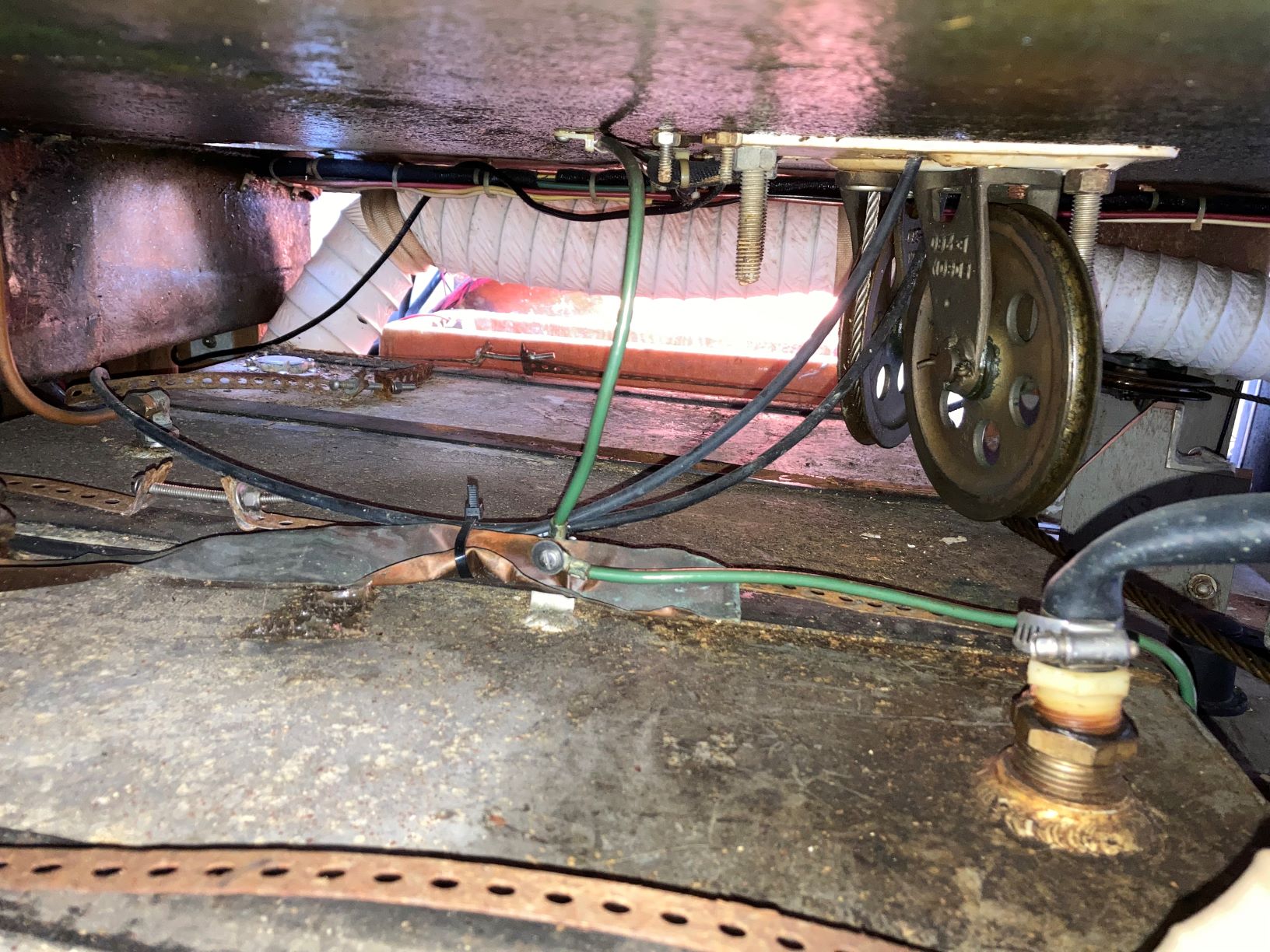

ParticipantMike,
See attached… one pic is of the fuel gauge face.
And the other is the top of the tank..
As you can see there is about 6 to 9 inches of space there between the top of the tank and bottom of the cockpit floor.. You can also see the light coming thru the cockpit floor in the rear left of the pic and the gauge directly below..
It might be easier just to remove the site glass and see if you can polish it or have another one cut.. It is held in by screws..
Hope this helps..
Mela..John
