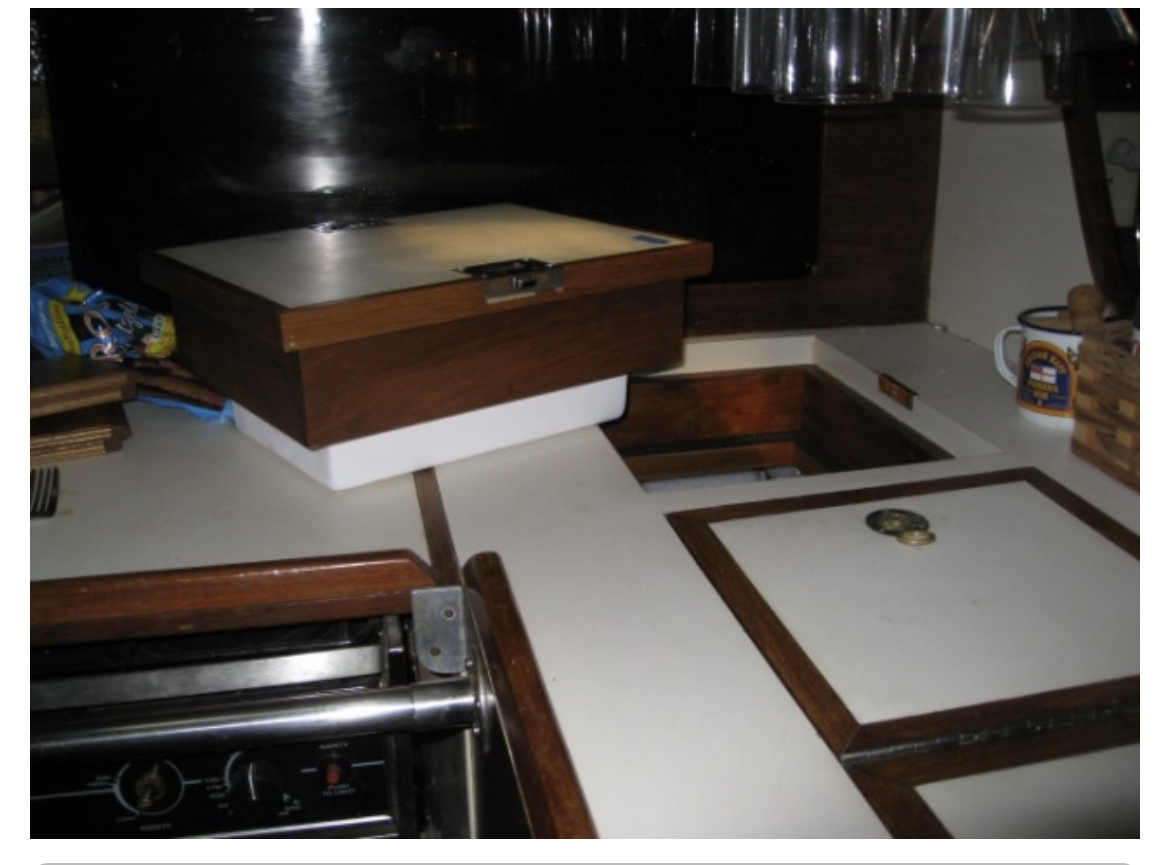

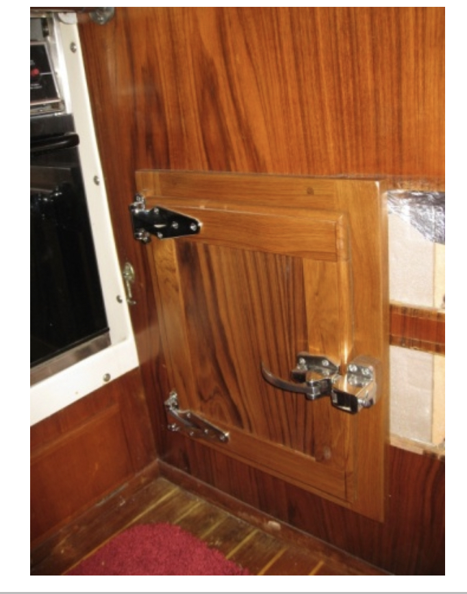

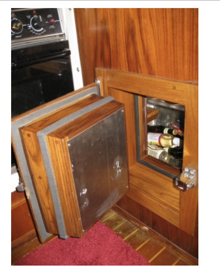

ParticipantIn the Photos section of this site are pictures of my modifications to the refer.
I split it half and made one side a freezer. It has two cold plates. The refrigerator side uses cold air as a spillover from the freezer.
I put a door in the lower half of the refrigerator to reach the stuff on the bottom.
I use a SeaFrost 12 volt system.
Very efficient.
I spent 3 years in the Caribbean with having ice all the time and plenty of frozen food.
Look for unabated refrigerator mods.1 user thanked author for this post.
