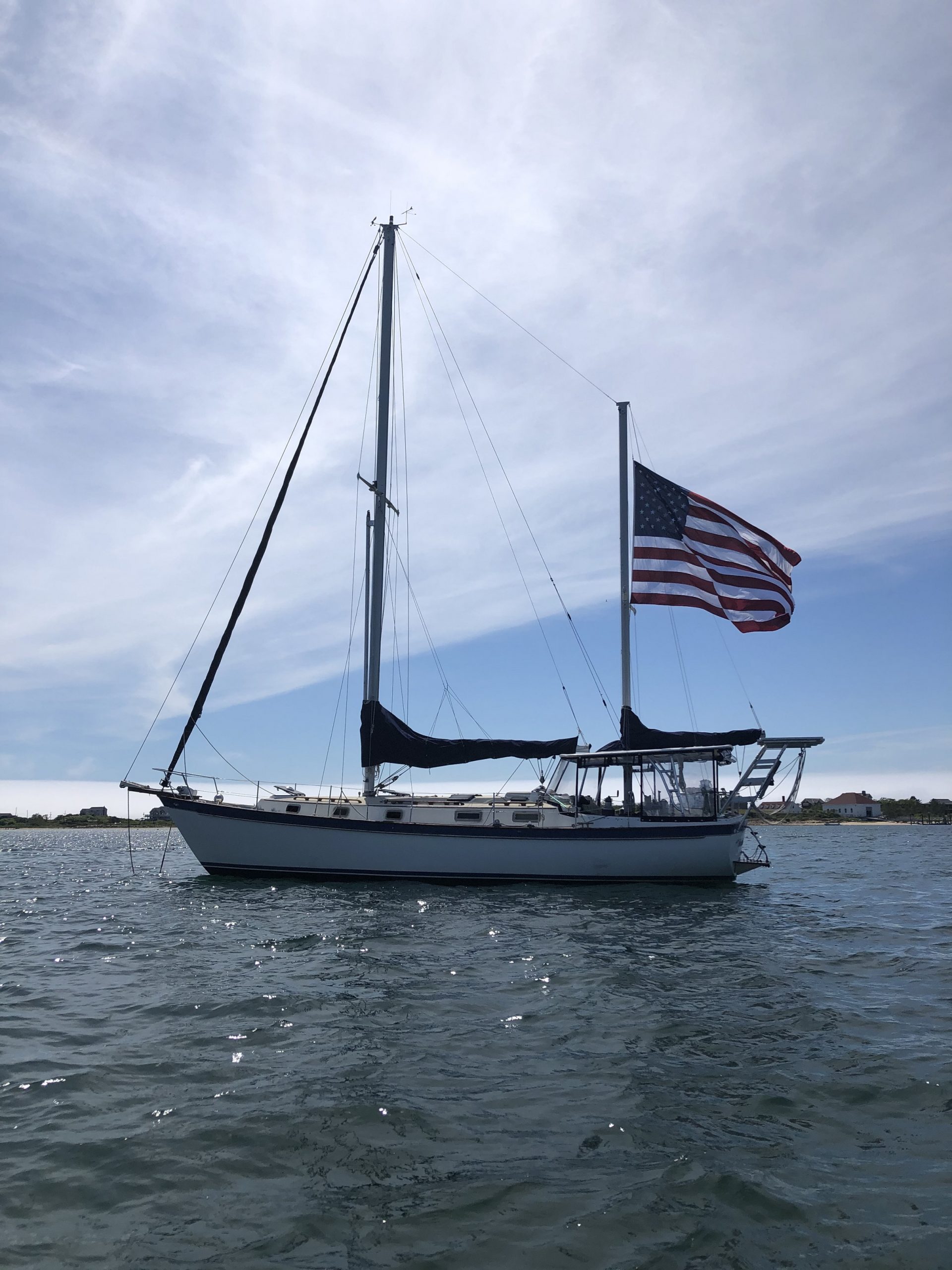

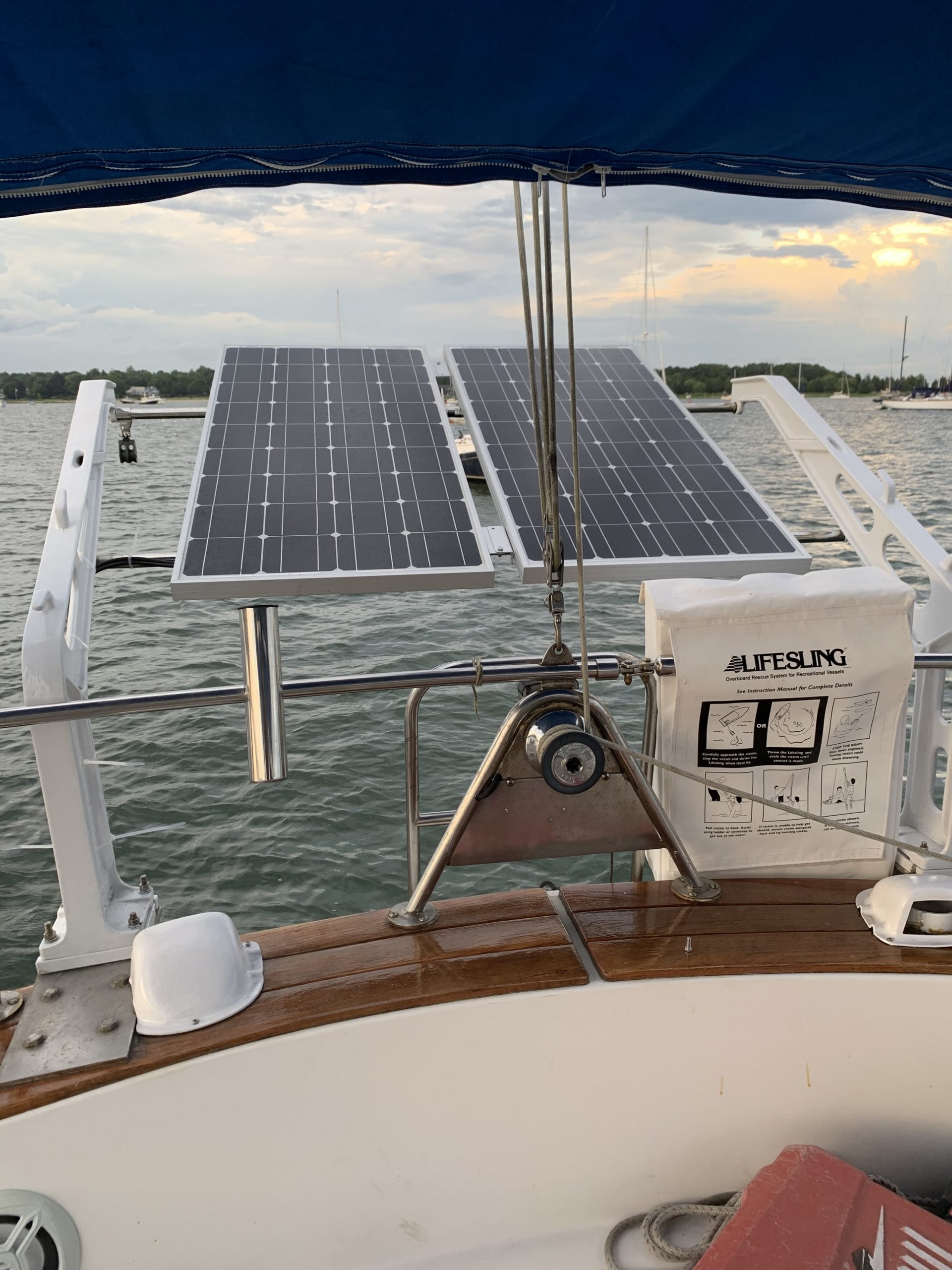

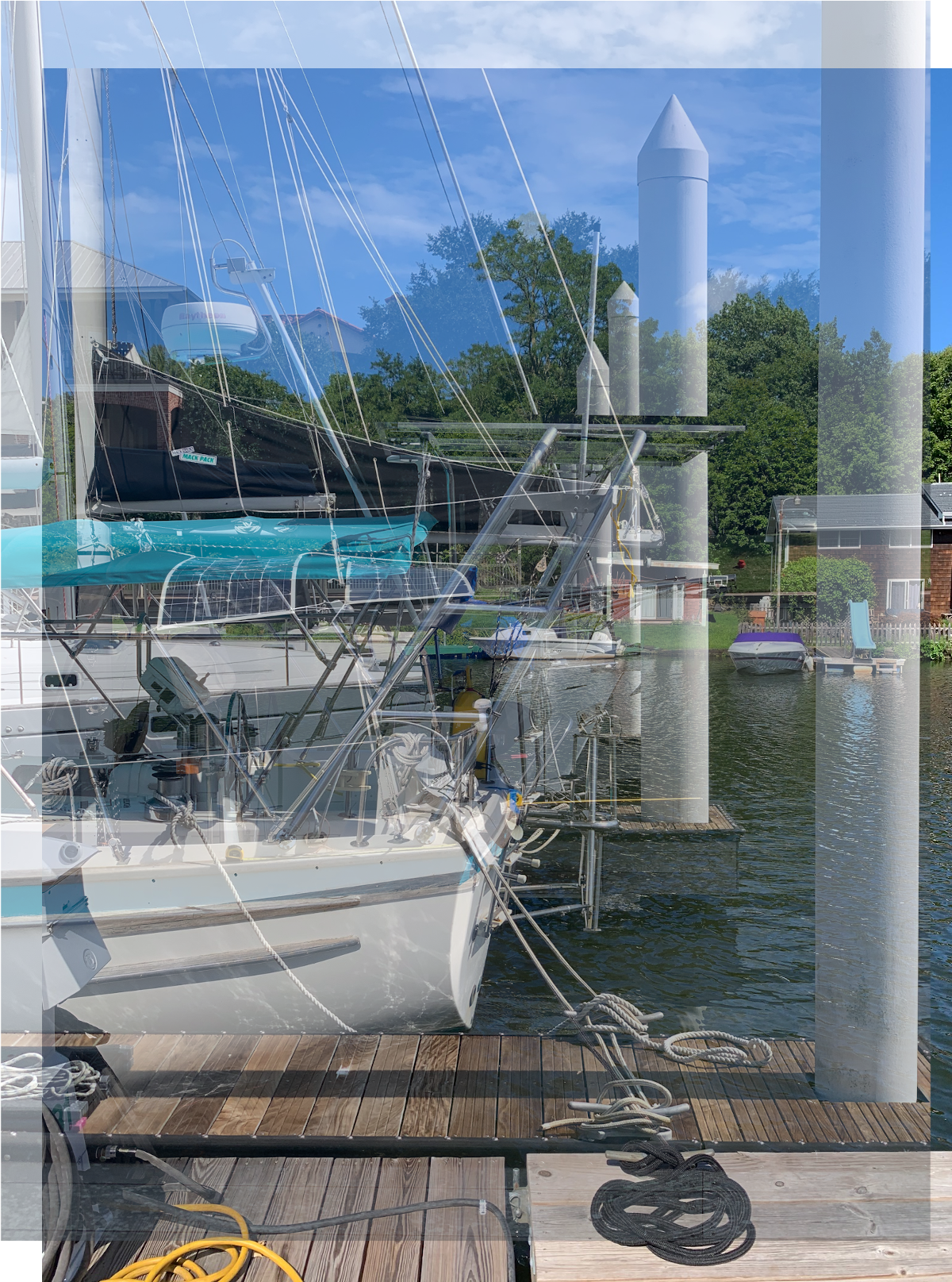

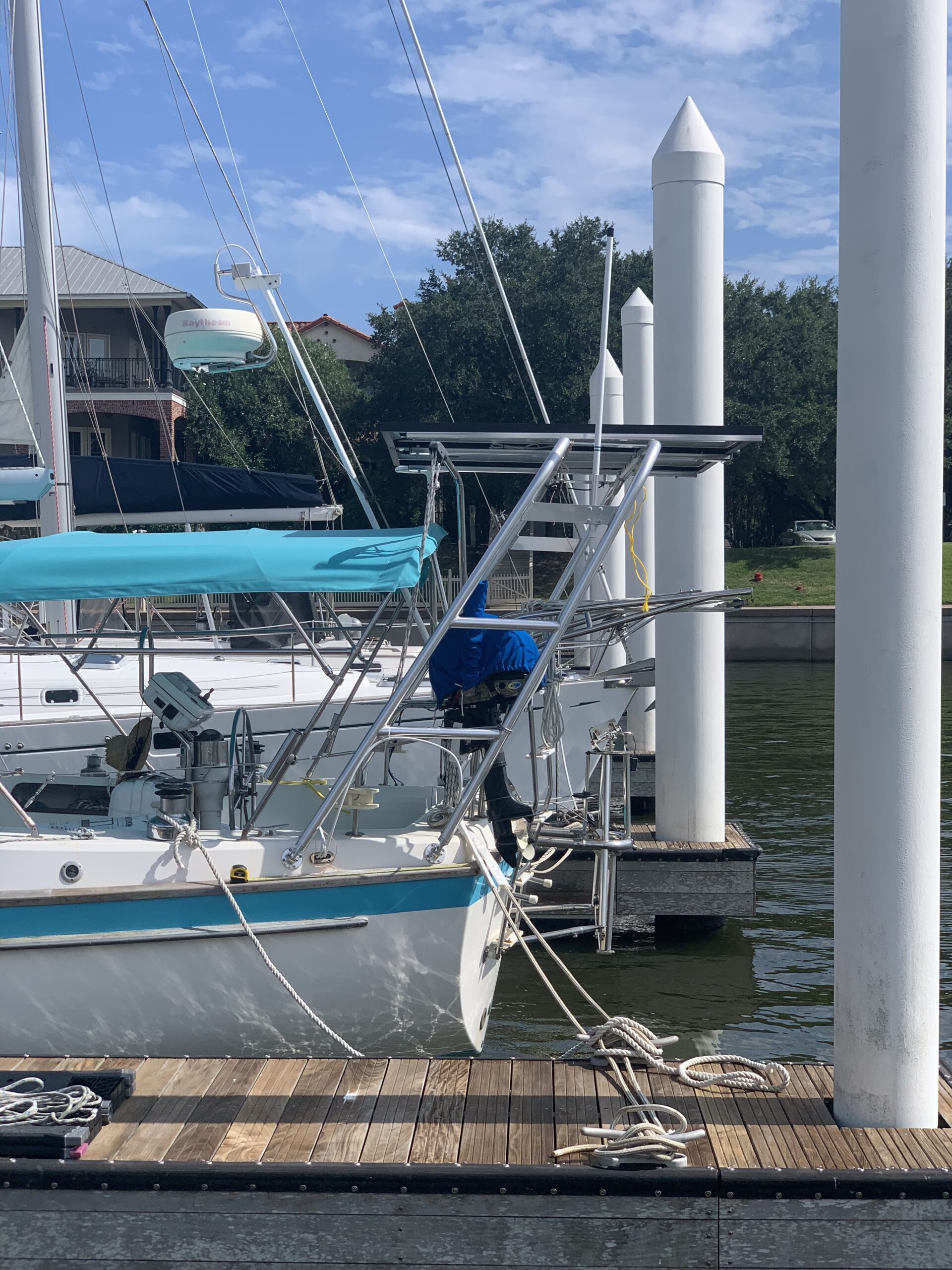

    in reply to: Solar arch for a ketch #225695
    Bryan Bywalec
    Keymaster
    Attached is a photo of my arch with a tape measure pulled out three feet for reference. I also overlayed the two photos and it doesn’t look like the arch-in-a-box sized for a cutter/sloop will work with the ketch rig.
    However, another user sent me a picture of his ketch with an arch that looks like what you want. I sent you both an e-mail to put you in touch and included the photo here.
    Lastly, Rich sent his solar davit solution as another option.
    I actually had trouble posting these photos myself… who runs this website? πŸ™‚
    Bryan Bywalec
    S/V Pelican, Hull 209
    Siren Engineering, LLC
    in reply to: Solar arch for a ketch #225690
    Bryan Bywalec
    Keymaster
    Bryan Bywalec
    in reply to: Solar arch for a ketch #225685
    Bryan Bywalec
    Keymaster
    Attached is a picture of what our arch looks like (with tape measure in the photo for reference). I also tried to overlay the photo you sent. It isn’t super accurate but you’ll see that the traditional arch-in-a-box size for a single mast 424 is going to interfere with the mizzen.
    Another user sent me a picture of the arch on his boat that does clear the mizzen. I think the trick here is that one of the sets of feet are actually on the transom rather than the sides moving the arch aft far enough to clear the mizzen. I’ll try to put you guys in touch.
    Lastly There is a photo of Rich Harris’ solar panels on davits under his mizzen to give you another option.
    Bryan Bywalec
    in reply to: Solar arch for a ketch #225680
    Bryan Bywalec
    Keymaster
    Bryan Bywalec
    in reply to: Solar arch for a ketch #225675
    Bryan Bywalec
    Keymaster
    Take a profile picture of the transom, if you put a tape measure pulled out 3′ or so I can scale it. I’ll overlay the same picture of my boat and you can get an idea of what you are up against. Probably best to e-mail the picture at bryan@iwouldsaygo.com
    Bryan Bywalec
    in reply to: Solar arch for a ketch #225672
    Bryan Bywalec
    Keymaster
    There are a few 424’s with the Arch in a Box, I think they are all sloops or cutters though. Our boat – the cutter Pelican – has one. How far does the mizzen stick out from the transom. The froward cross bar of the arch is just about even with the transom in our case.
    Bryan Bywalec
