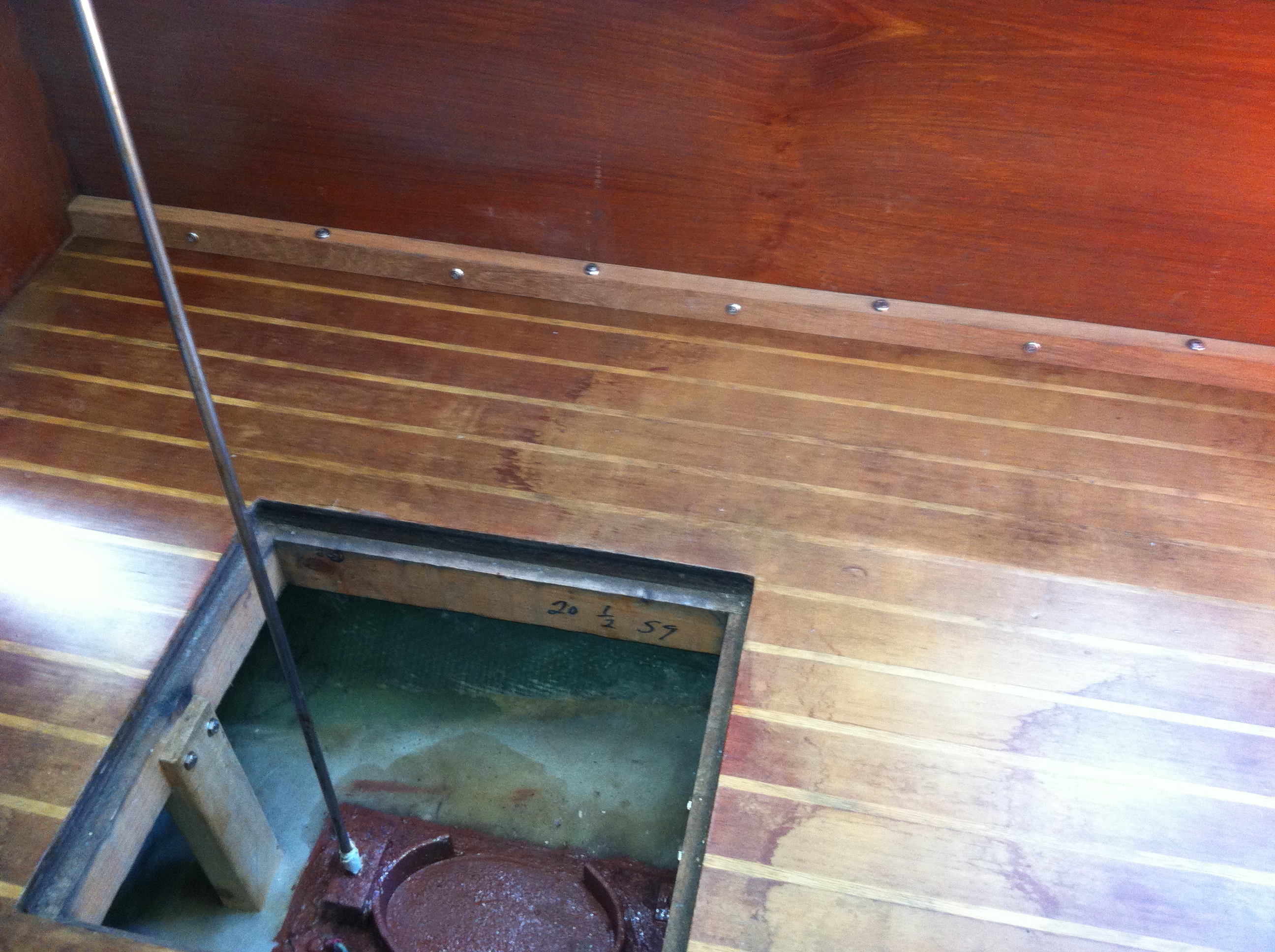

    Hi David and Pat
    What follows is a reply I sent two or three weeks ago in reply to David’s original message on the cabin sole problem. I’m guessing it never got out so I am trying again without the photo attachments. If it doesn’t come back to me I’ll try the forum.
    Hi David,
    I tackled this problem about three or four years ago and sent a write-up and photos but have not been able to find them in the archives. I expect that it may have gone only to another owner who was working the problem at the same time.
    Pearson depended on the stiffness of the vertical board that forms the face of the settee for support of the forward part of the main cabin sole by using a cleat fastened to the inside of the board and wood screws into the plywood sole. Water damage (from overfilling of tanks) ultimately caused the screws to pull out and the sole to sag. My first thought was to try to jack the sole and replace the screws with thru-bolts but found there wasn’t enough access to do that. My solution was to put a teak cleat on the visible side of the settee board and thru-bolt. I also added vertical supports forward and aft of the mast. I’ll try to attach photos to this message but if unsuccessful perhaps someone can instruct me on how to send them.
    While you are working under there be sure to have a look, farther aft, at the bolts attaching the athwart-ship structure to the vertical members supporting the galley area etc. If I remember correctly, the nuts had come off three of mine and two of the bolts had backed out enough to disengage completely. Fortunately there is not a lot of clearance between the end of the vertical supports and the structure above so the sag, there was not too bad. Nevertheless it was pretty unnerving. I was able to get everything jacked up and reassembled working through the hatch next to the ice box and the mast opening with a selection of long socket extensions. The scisors jack from my car with it’s long handle was the tool of choice for the jacking.
    Phil Fontaine – Aurora
